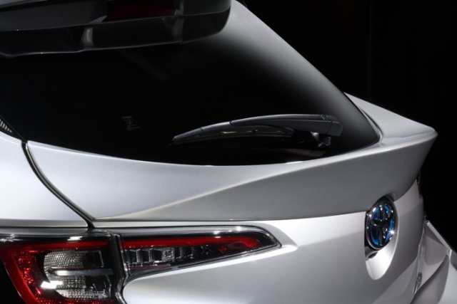

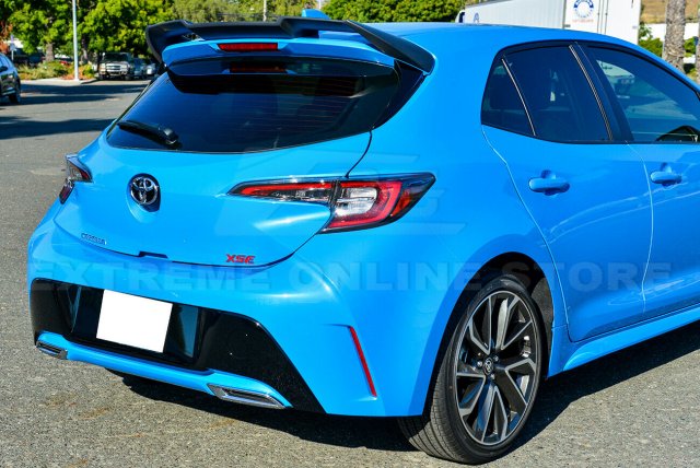

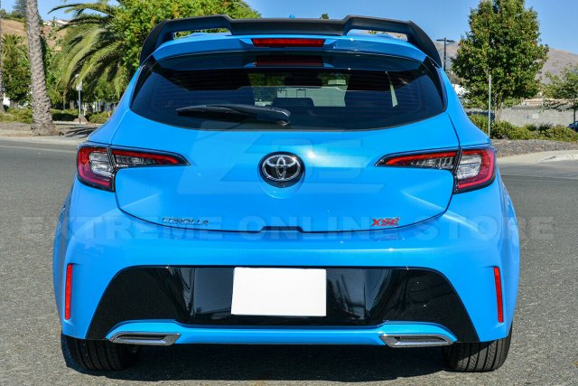

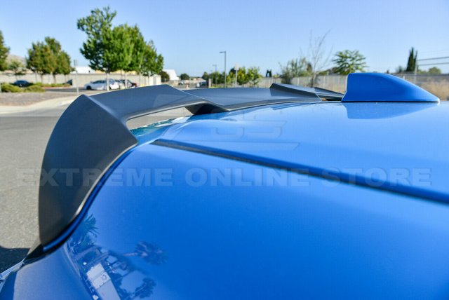

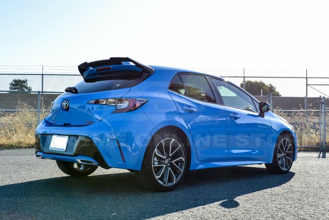

Possible rear spoiler extensions for the GR Corolla Core
This might be a good contender to make the standard GR Corolla Core spoiler look sportier.

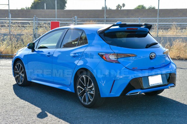

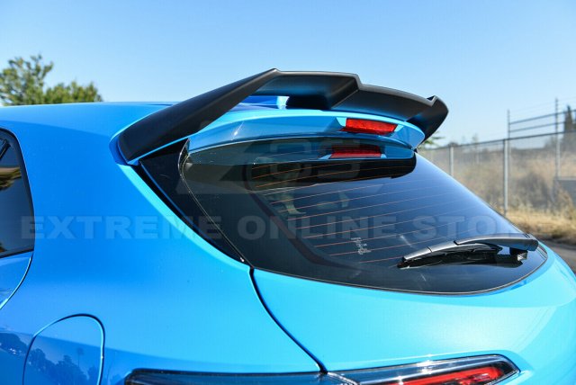

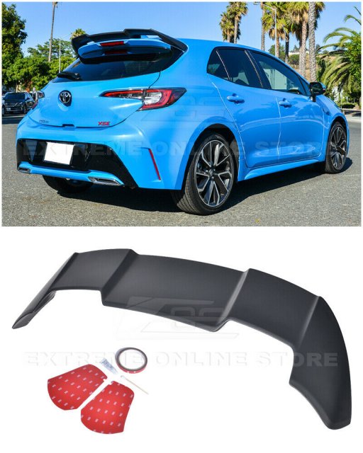

Attaches on with double-sided tape
I think it looks much better than this.

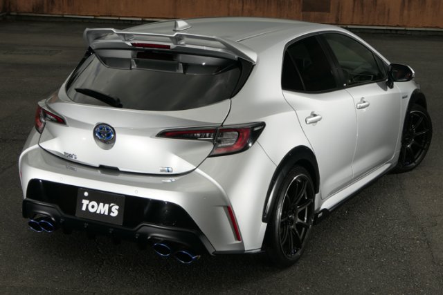

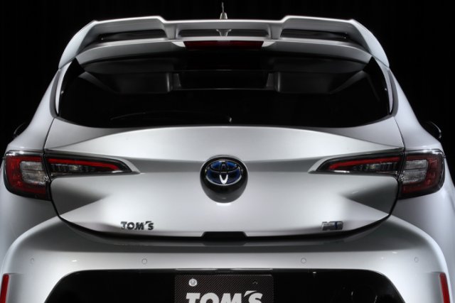

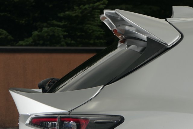

Check out the Mid Spoiler from TOM's Racing.:love:

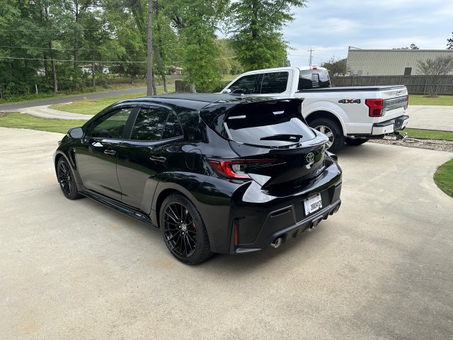

This is the Toyota CE wing purchased at the dealership. It cost me right at $800 and took about 1.5 hrs to get it placed correctly. There was some drilling involved into the hatch, as its not held on with just 3m tape.

Here is the gloss black option: PT938-12230-02
The is a real good Youtube video from one of our forum members, Anthony Do, installing the wing. The Toyota dealerships I called: 1st said they would not send back if it arrived broken, second dealership was really good and had part delivered from warehouse in a day. I drove down to pick up. He did say if it didn't fit, than that's on me. It fits! Good luck! BTW there is a flat black option too, but I do not have part number.

@Td66 was it super hard to drill the holes? Also did you get it painted or was it pre-painted?
#10
No just wipe some white silicone, toothpaste, or Elmer's glue on the tabs that go through the hatch. test fit the wing and press lightly to mark where to drill. Do those three in the middle and attach first, then come back and do the two sides once the wing is loosely fastened to the hatch. It was pre painted.
